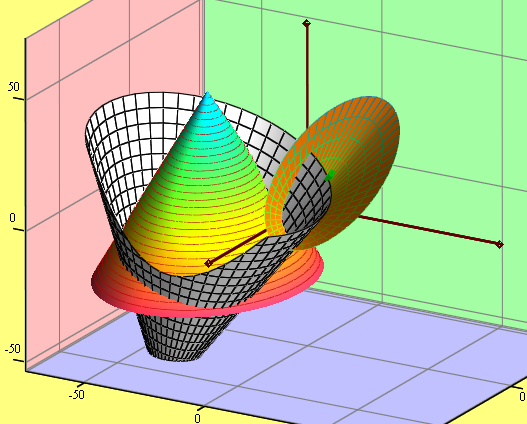

Here is a more generic routine to generate a cone along with an animation to explain the arguments of the function.
In your first plot there is no easy way to make the edge circular. However, other than a small detail, you got it in the second plot. It you put F1, F2, F3 in the placeholder then Mathcad interprets that as three plots, where the the z values are given by F1, F2, and F3, and the x and y values are the points on a rectangular x-y grid, determined by the quickplot parameters. If you replace that with (F1, F2, F3) Mathcad interprets that as a single plot where the x, y, and z values are given by F1, F2, and F3. Then you will see what you are looking for.
Thanks for the routine and the animated illustration. I can understand how to use the routine and (mostly) how it works. Something that I did not understand was how the axes plot (both the cone axis and the black rectangular axes) and why the order matters in the plot arguments; eg. "ax, C1, cax1" vs. "ax, cax1,C1".
To plot a polygon in 3D you have to provide a vector with three elements. Those elements are vectors again, consisting of the x, y, and z-coordinates of the vertices of that polygon. If you want a closed polygon you have to provide the first point as last point, too. For the axis I created a datstructure with five points. Starting at the "end" of the x-axis to the origin, to the "end" of the y-axis, back to the origin and the to the end of the z-axis.
Similar the data structure for the cone axis which is M12 in the routine provided. Simply two points.
BTW, if you want to draw one single point in 3D (lets say the point of intersectio of three planes or whatever) you have to provide that very datastructure again: A 3x1 vector consisting of three 1x1 vectors.
The important thing is that those polygon plots have to be formatted as "Data Points"/Scatter plot" /the name changes now and then for reasons unknown to me) in the 3Dplot format menu. There is a bug in the 3DPlot component and when ScatterPlot does not work, chose VectorFieldPlot, press OK or Apply and then change it back to "ScatterPlot". Then in tab appearance you chose to draw lines and/or points, color and size.
I don't know why you think that the order matters that much - maybe thats because you forgot to change the plot type,(Scatter vs Surface) too, when you changed the order.
You might also create a data structure like in the attached sheet, where 3D-ploting ax would result in three different plots which can be formatted differently and so you can color the axis differently for better view.
