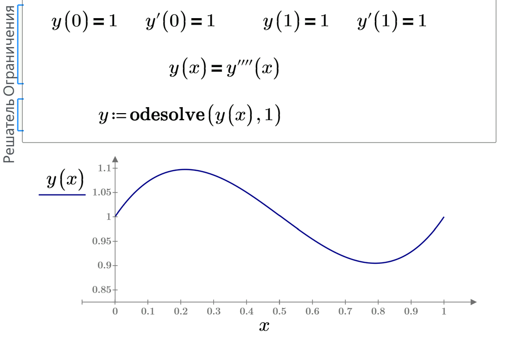

Dear, I'm new with Mathcad and do not know how to solve a 4th order differential equation with boundary condition, see Maple Solution

Please attach Mathcad worksheet with your solution to the message.
ValeryOchkov
(To:Roj)
Mathcad can solve Odes only numerical!
