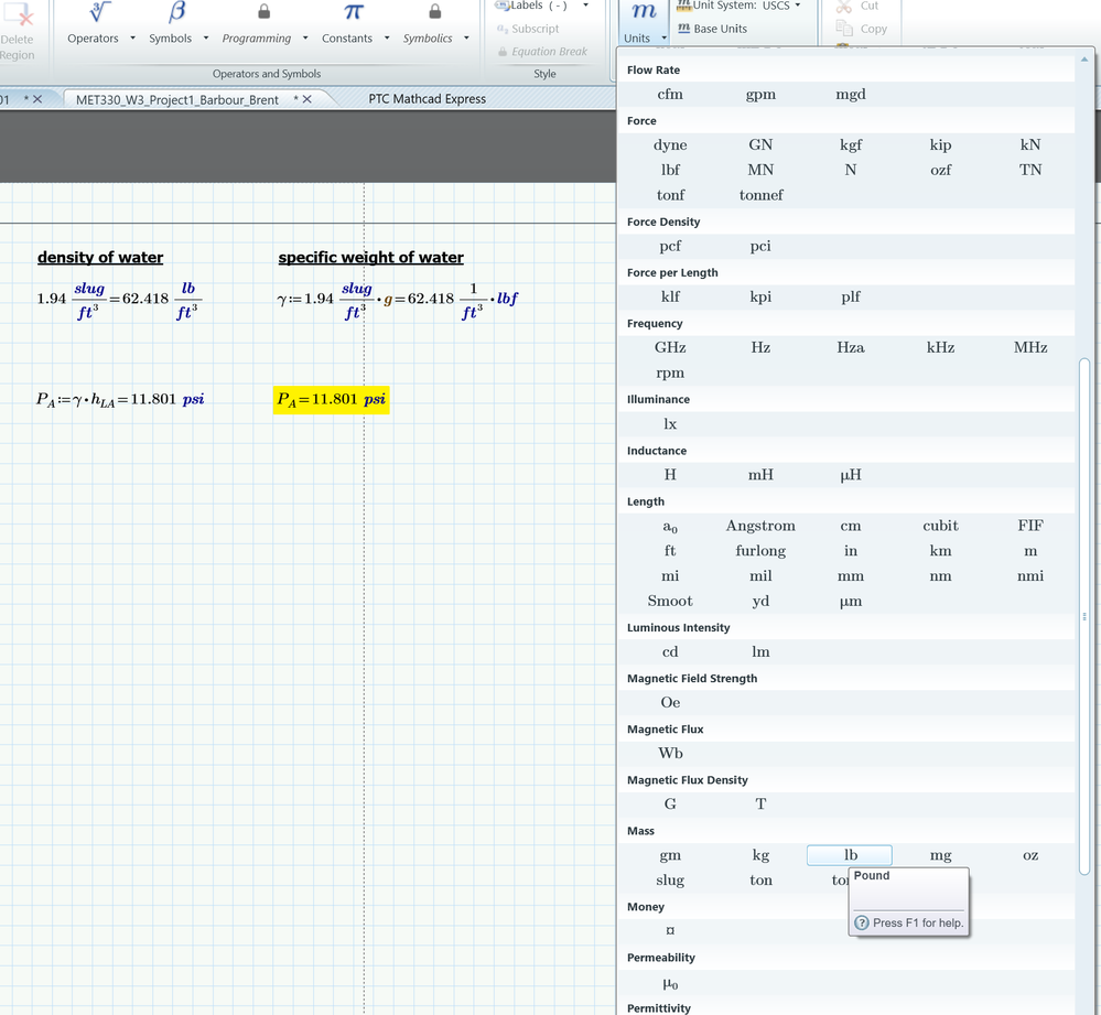

I'm using MathCAD Prime 9.0.0.0. MathCAD is always forcing Units of Measure. Usually it'll choose appropriately based on the data going into it. However, sometimes it's wrong or uses weird units and won't allow me to override. A work around is I can not use units at all or I can put in a 2nd equation without units, but I shouldn't have to do that. One of the advantages to MathCAD is I can use multiple units in the same equation and MathCAD knows the difference. In this case...

Change lb to lbf.

Change lb to lbf.
Perfect! Thank you!!
What you've defined g as is the density of water.  The lb is a unit of mass in Mathcad USCS, not weight (force).   Here is the corrected specific weight of water, which automatically corrects the problem with PB.
