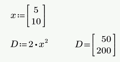

I also found that using a X by 1 matrix will also work.
(To:cfelice)
This method is a bit limiting compared to a functional approach, but if thats what you need - why not.
But use it carefully - depending on the calculations used the method may fail.
This works:

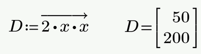

But written this way the result is not what you may expect.
Reason is that x*x is calculated as vector dot product.
You can fix it by applying vectorization - which is advisable to use always when you want a calculation written for a single scalar should be applied elementwise at the elements of a vector.
The first example (using x^2) worked because Prime applies automatic implicit vectorization if an operation (like squaring) is not defined for vectors.
