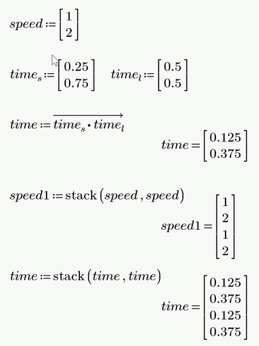

Is not really clear to me what you actually are trying to achieve. Your desired results simply consist in the given vectors, just doubled (stacked) and the new times vector is the vectorized product of the two given time vectors, and then also doubled.
Could be achieved that way:
For further questions please state more clearly which calculations you would like to be done and don't forget to attach you worksheet, not just a picture. And its also advisable to state which version of Prime you are using - especially in case you are not using the latest version.

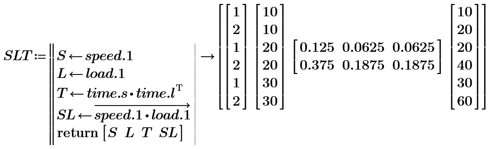

I still need more help, see the file attached. I gave very simple vectors trying to be brief, but they don't have to be the same size - then I can't vectorise time.
So, in my updated example I have 'm=2' number of cases for speed, and 'n=3' number of cases for load, and I need all the possible combinations - the resulting vector size would be m*n=6. Time vector would have a product of corresponding time shares - time share for particular load at particular speed. I hope it will be clearer with the example.
I know that I work with single values in my attempted example - and I wonder how I can apply similar logic to ranges. Also, I wasn't sure about 'return' syntax and function callout - I needed to return three arrays, and it seemed to be accepting scalars only.
I have Prime 9.0
Thanks again,
Ieva
(To:ID_8050255)
Here are a few suggestions demonstrating different ways to create the vectors or matrices.
If you have any questions or need something different, feel free to come back and ask.
Prime 9 sheet attached
ID_8050255
(To:Werner_E)
Thank you much! Just what I need.
