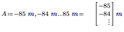

im getting another error in defining the range.
(To:MM_10735997)
Ranges and vectors are quite different beasts bust unfortunately look the same when displayed in Prime.
Furthermore you forgot the unit (meter) when you defined A.
There is an undocumented trick to turn a range into a vector by simply immediately  evaluating it in the same region where you define it:
Now A is not a range anymore but a true vector.
A more "legal" way to define the very same vector is using a range i which is needed to index the elements of the vector.
Note that the index used is a vector/matrix index, not a literal index.
Once you defined the vector A either way, the definition of the vector B works as expected and also the calculation of the vectors X1 and Y1 (feel free to use better names):
