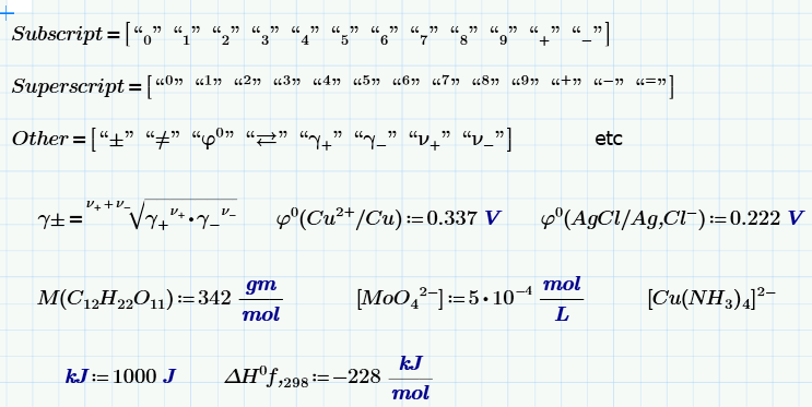

But see one my chemical calculation in Prime

In your sample, I see your variables in square brackets; e.g. [Mg++].
Is it not a matrix variable? If so, how did you create it?  Please reply.

I copy variables with square brackets from one old sheet and edit it in one new sheet!

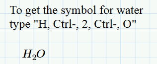

Prime works a bit differently.
To get a literal subscript in Prime it's "ctrl -", the control key and the minus sign.  This toggles, however.
To get the symbol for water  type "H, Ctrl-, 2, Ctrl-, O",

Thank you very much Fred. I did not know it.
