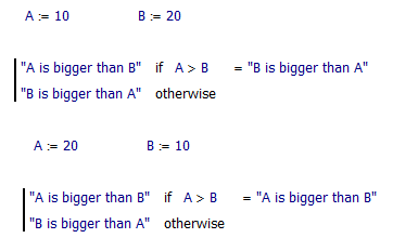

Is it possible to make Mathcad compare values of two variables and display the result in some way?
For example, somehow make user know that variable A is bigger that varable B?
Very basic example.
There is a number of ways this can be done though.

Very basic example.
Mike Armstrong wrote:
Very basic example.
There is a number of ways this can be done though. ...
... such as this method in Prime, which has the advantage that it will also work in Prime Express as it doesn't require the programmed if and otherwise.
Stuart
Thank you! I was able to make use of these examples.
