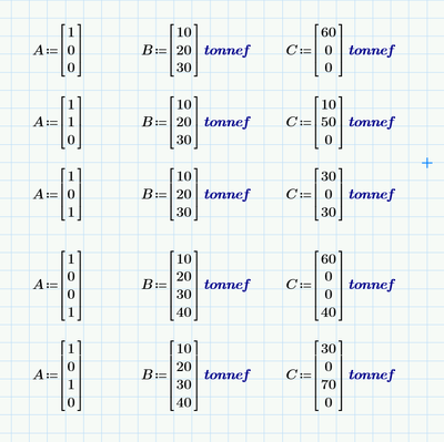

I have a vector [A], which could have any number of rows, each element can be either zero or one, and the origin element is always one.
I have another vector [B], which has the same number of rows as [A], and contains data (forces).
I would like to create another vector [C], where each element in [C] should equal the corresponding element in [B] if the corresponding element in [A] equals one. If an element in [A] equals zero then that value in [B] gets added to the last element in [C] that related to a one in [A]. That continues until another one appears in [A], and it starts again. Elements in [C] that correspond with zero elements in [A] should equal zero.

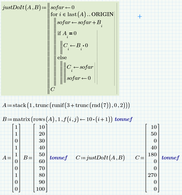

I guess this function should do the trick
P6 file attached
Werner_E25-Diamond IAnswer
October 14, 2022
P6 file attached

Fantastic! Thank you.
