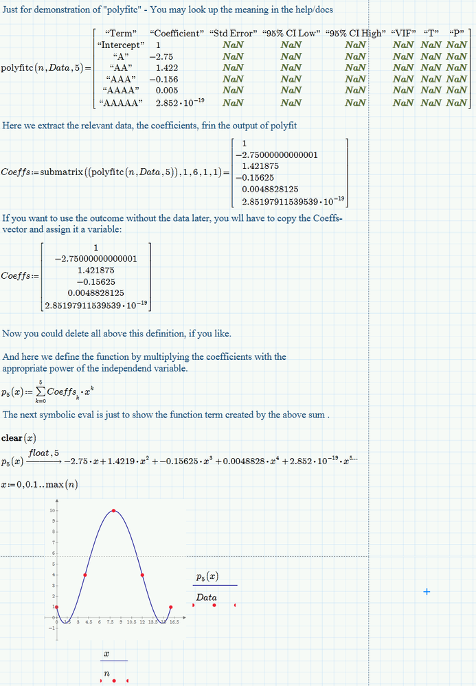

Here is a sheet in Prime 3.0 format.
Hope it helps.
To use the function without the data availabe you would copy simply the "coeffs" vector (set Prime to show more decimals for better precision) and assign it a variable "coeffs" which you then can use for the function definition as shown.

That is why you use the regress function. It provides the coefficients of the polynome:
you can write myf(x)=a*x^2+b*x+c with a=-0.357, b=1.643 and c=2.

Not using polyfit, no. Use polyfitc instead (which replaces regress) to return the coefficients of the polynomial, then use the coefficients to define a function.

In addition to what Richard has shown, you can also symbolically evaluate the equation poly(x).  This will show you the exact equation being plotted.
Edit: example
Hope it helps.

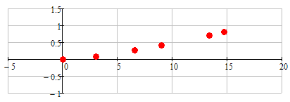

Just leading on from this I have been playing with this again with the most simple of excercised i.e. x=y in the attached. This does work (providing the coefficients are accurate enough i.e. have enough decimals) but I was looking to see if MC can tell you what function the line/ curve is. i.e. in this case you would expect the result x=y or y(x)=x. I guess this is not acheiveble?

No, Mathcad cannot do that. Neither can any other software. There are an infinite number of curves that would fit any data to within acceptable tolerances, so without other information it is not possible to know what "the" curve is.

Your guess is correct. As Richard already explained, thats a mission impossible.
When you see this, what would you think, the equation of the underlying function is?
Perhaps we have here a linear process with a few inaccurate measurement results?
Lets reveal the secret - I used the function equation seen in the picture
You may say, that the straight line above wasn't a perfect match anyway - thats correct.
But here are two perfect matches - all six points lie exactly on the curves.
Here we have y=sin(x):
And here is a polynomial of sixth order:
And there sure is an infinite number of other function which include those six points perfectly.
So what should Mathcad return? 🙂

I intentionally duplicated Val's number to illustrate that polyfitc and regress will create the same numbers.  Richard showed that you can "cut them out," and copy them from one worksheet to another, and the same function definition (from Val or Richard) will develop the polynomial as a function.
