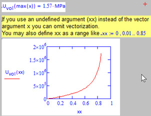

The uvol integral works by using an overbar.

You are wondering why in Alan's sheet the integral utot works now for you? The reason is that he disabled your TOL setting and so the default TOL=10^-3 is valid now.
Setting the value of TOL to lower values (10^-4 or lower, as you did) increases the chance of the integral NOT converging!
Your approach with U.vol works without vectorization if you use an undefined variable (quickplot) or a range as argument:

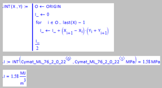

As to the trapezoid rule - here is an approach using your raw data:

This is what I'm talking about.
Note that the definition of integration is nothing else than summing vertical bars of infinitesimally small width, and height equal to the function value at the (ordinate) mid point of each bar.
Now you choose the best approximation.

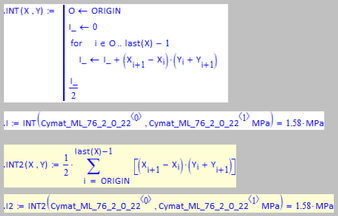

(To:LucMeekes)
I agree that its more elegant to replace the for-loop by the summation operator:
