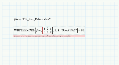

Mathcad is able to read my existing Excel file, but when i want to overwrite data using the WRITEEXCEL function i get the error: a call target threw an exception. The problem seems to be the matrix. Did I do something wrong here?
LucMeekes
(To:DFrancke)
The file must NOT be open (in use) by Excel itself at the same time.
As said, I don't understand the function of the parameters cols and rows (the two ones) in the function call, is not described in the info about WriteExcel. What happens if you leave that out?

The problem was caused because my Excel is set to Dutch. "Sheet1!" apparently had to be replaced by "Sheet1!". Now it is possible to write the data to an existing file.
