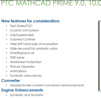

(To:AS_9781967)
Frame animation is planned for version 9, 10, or 11
PTC Mathcad Prime Roadmap (2021 update) - PTC Community
2023, 2024 or 2025 hopefully sooner than later.
Bob (Ranteng)
