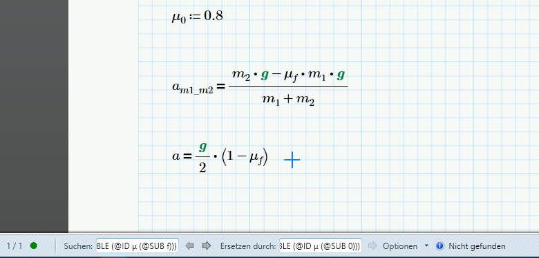

Hi All,
I want to change automatically with the Function "Suchen und Ersetzen" the variable my_f by my_o in a worksheet.
This is a quick example:
I can do what i want but th Funktion does not replace the variables.
I'm running MCP4.0 latest Version and i had the same problem when running MCP3.1.
Platform is Windows 10
Has anybody the same problem?
Or is it again a typical saving of PTC to save development costs?
Thank you for your efforts!
Volker
Volker
(To:vlehner)
You demand too much from the people of PTC.
You don't really expect a working search and replace in a software like Prime, don't you?
Copying the variable name from the sheet to the S&R box does not even work with normal, non-indexed variable names.
Copy and paste generally seems to be a big problem of Prime.

(To:vlehner)
vlehner
(To:Werner_E)
I had actually thought of that but the confirmation follows immediately on the foot.
We should rigorously demand a 90% discount.
(is it the remaining 10 percent really worthy?)
Volker
(To:vlehner)
Would be more than fair given that we still get Mathcad 15 for "free" along with Prime.
Doesn't work.
Hasn't ever worked in Prime.
Major frustration.
