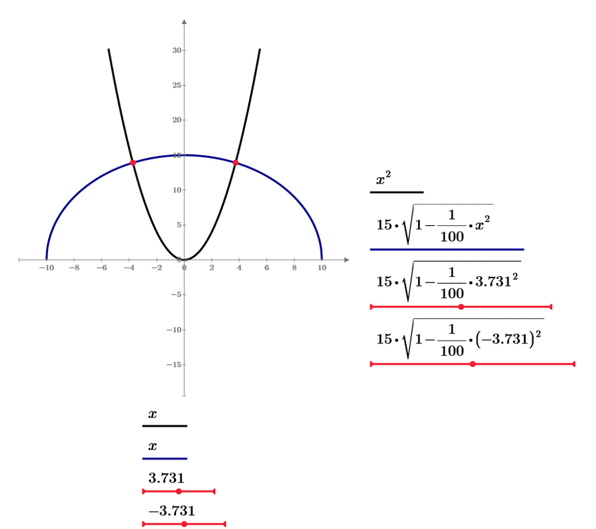

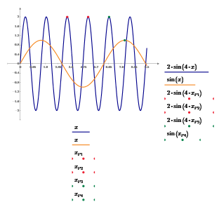

1.  How to find the intersection points for the below graphs (the red points)?

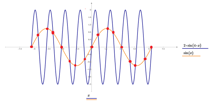

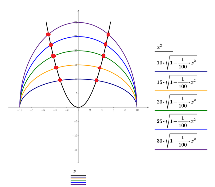

2. How to find the intersection points for the below graphs (the red points)?

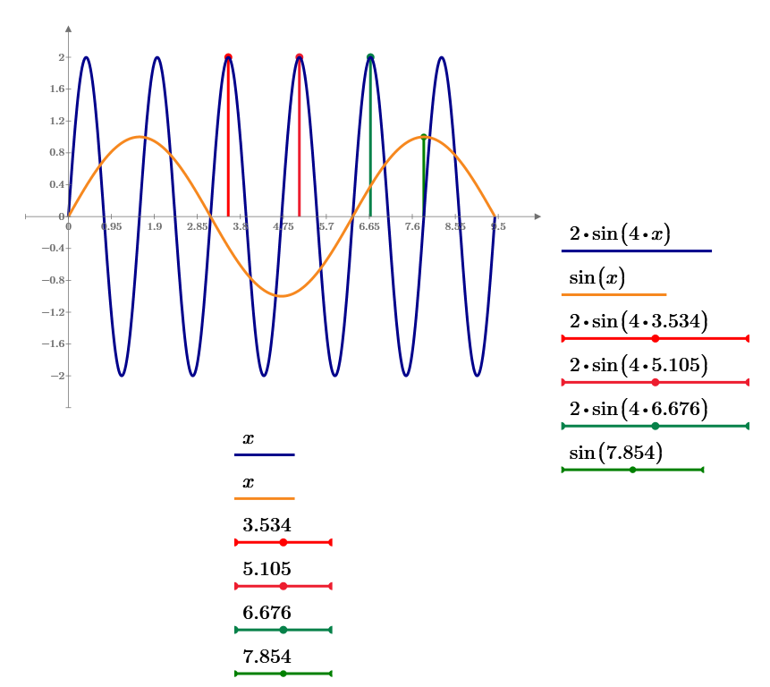

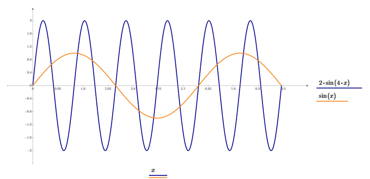

3. How to find following distance between the two peak of blue graph, and between the one peak of the blue graph and one peak of the orange graph from below?
Mathcad Prime 8 file attached.
LucMeekes
(To:Cornel)

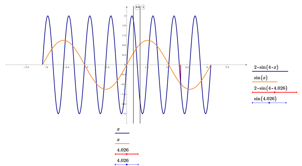

Use the (bracketed) root function to find individual crossings and/or the symbolic solve to find All.
6 REPLIES 6
LucMeekes
(To:Cornel)
Cornel
(To:LucMeekes)
Cornel
(To:LucMeekes)
EDIT: ONLY in this way, evaluating and plotting one of
or
or
or

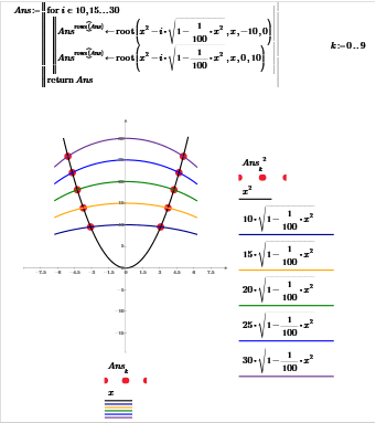

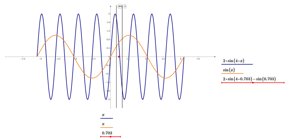

Cornel
(To:Cornel)
@LucMeekes
For point 2:
And so on.

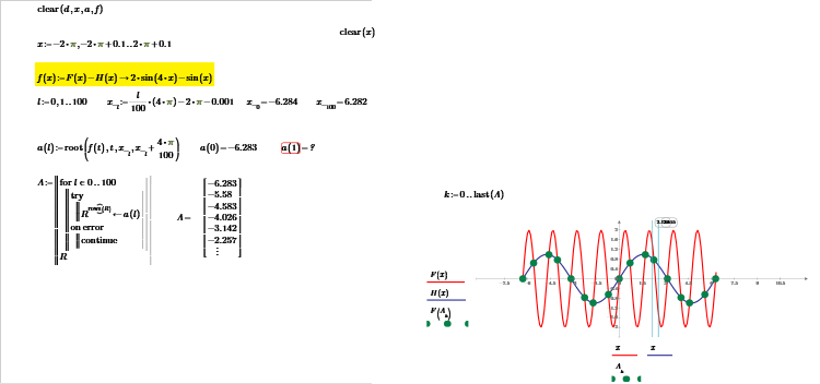

So, point 3 remains..
Cornel
(To:Cornel)
@LucMeekes
For point 3, one variant:

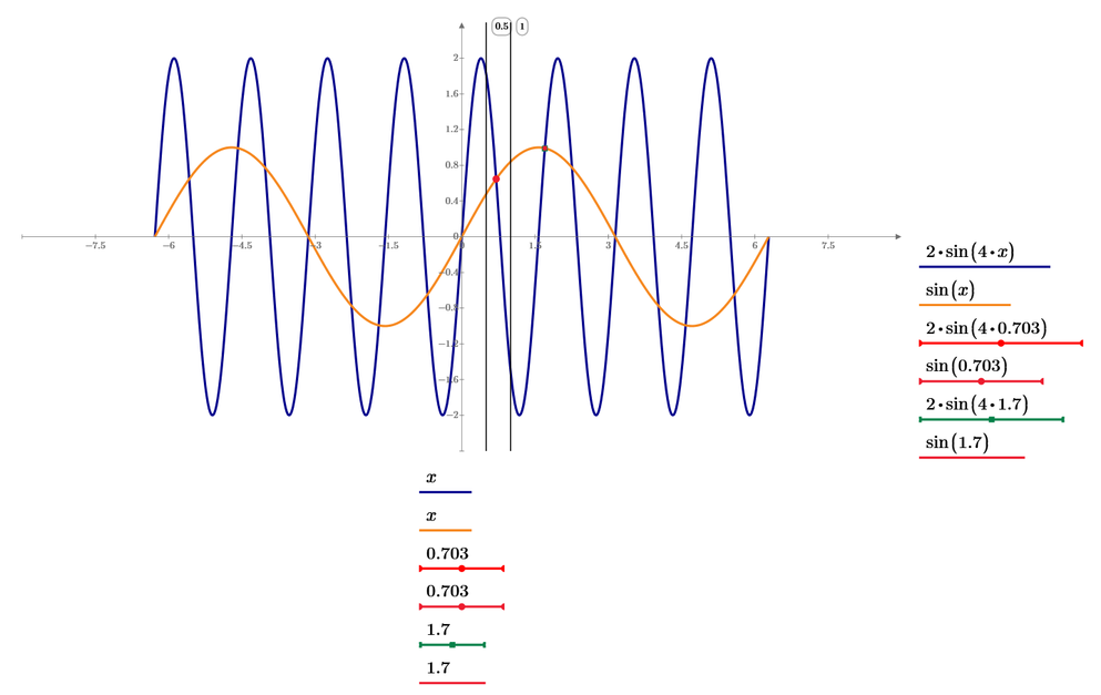

ttokoro
(To:Cornel)
