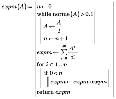

How to make this function to work also for scalars, if possible?
Cornel
How to make this expm function to work also for scalars:

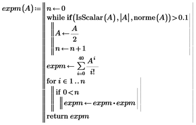

You can use the function IsScalar(), like this:
5 REPLIES 5

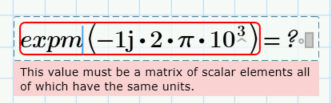

But right now I inserted manually 1x1 matrix element.
So, giving a scalar value like (or any scalar value):
expm function to be able to transform this scalar into 1x1 matrix element. Is it possible like this to add something like that in the above expm function? Or I need to be careful and put manually the 1x1 matrix element like above when I want to perform a calculation with this expm function with scalar values?

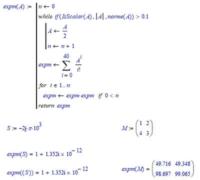

In (express) Prime your function could be:
then:
gives:
and:
gives:
Cornel
(To:LucMeekes)
Works also with your first suggestion also in Prime:

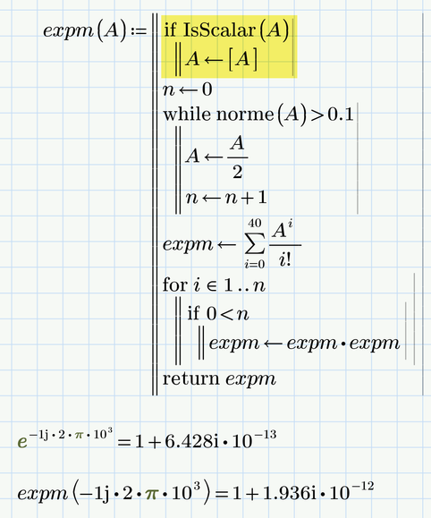

(To:Cornel)
if A is a scalar, simply turn it into a 1x1 matrix
