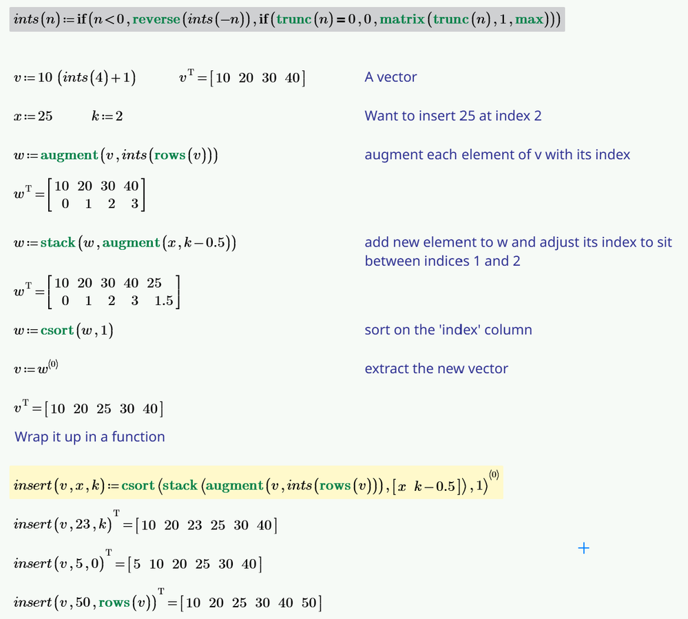

Here's one way, provided you want to add an element to the bottom, top, or middle of a vector.
There are other ways that more literally insert an element into a vector.
Stuart

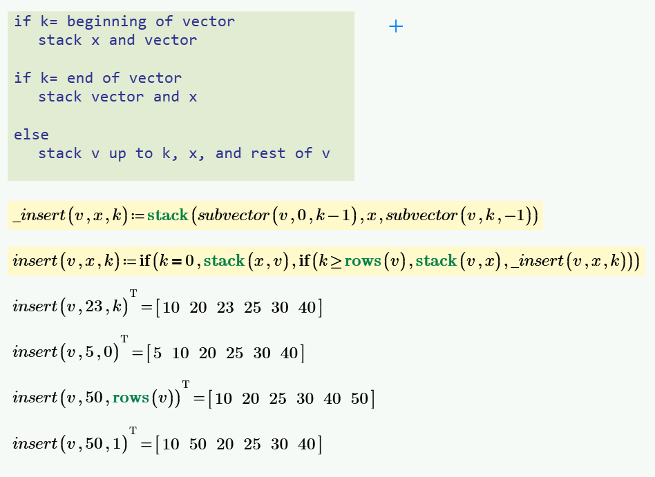

I'd add another standard form (in Express, so no programming), but I've almost learned the dangers of trying to program or read whilst dinner is cooking on the hob!
Soup is nicely bubbling (eye of newt; goes nicely with the toasted bat-wing sandwiches), so ... time for one more method.
I added an extra test value to demonstrate that the order of the v & x values doesn't matter, just the indices.   You could also write a program that does essentially the same thing.
Oh, forgot to mention, neither stack nor augment inserts values into an array; they just prepend or append values.
<Caveat>I haven't properly validated the results.  You may wish to do so</Caveat>
Stuart

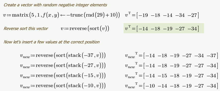

Hi Yusra,
Given that your z vector is depth-related, a natural assumption is that adding a new value should maintain depth-order.   Hence, using my telepathic skills, Alan's suggesting the use of reverse after sorting.  Which leads to a slightly more straightforward solution.
I wasn't sure whether you wanted to retain the depth order or needed to put a specific value at a particular index, hence the more general-purpose insertion suggestion.
Stuart
