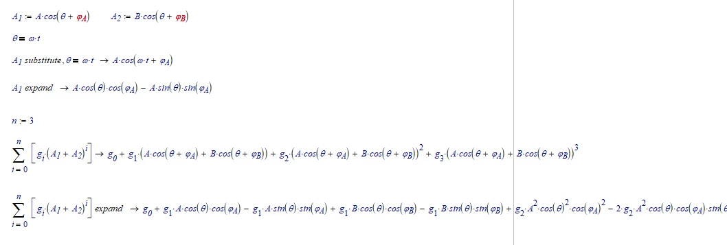

I would be grateful if someone can help me to know how to derive the trigonometric equations without getting a solution as in the attached thread. In other words, instead of driving the trigonometric equations as per attached, the software does this for me. Thanks in advance
Best answer by LucMeekes
You mean like this?
Note that the last equation runs more than 5 pages to the right!

It's not clear what you're asking for.  Your first two jpg's have no equations, the last only has three; there's no discussion about the series.  You can do this:

I have a polynomial equation as in 1.jpG. I just want to use the PTC MathCad to do the whole steps as in 3.jpg rather than doing it by myself. Does this software do like this or not? Thanks inadvance
