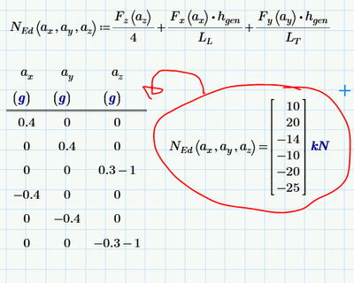

@JP_9979155 wrote:
I just went thru those videos which are very useful, but the question remains unsolved.
How do you do if you want to include the formula in the table?:
cheers
Juan
I guess the requested functionality is not implemented. I was able to create following notation.
Please read https://community.ptc.com/t5/Mathcad/Table-Basics/td-p/321822 discussion.
