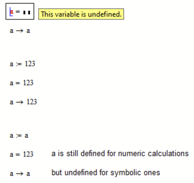

A:=A makes the variable undefined for symbolic calculations.
If you delete the assignment A:=0, the variable is undefined anyway, so A:=A is not necessary.

Thanks for the clue, but the problem was that I had already set A:=0 a few lines above and did not remove it when I tried to put A in the initial conditions. It worked still leaving A:=A disabled. BTW do you know why it is necessary to set a:=a, etc. I modified this program from one Alvaro posted a few years ago in reponse to another question i had. I copied this but never understood it.
