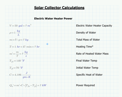

I use MathCAD for Engineers without Borders work, and I have been using it for 3 years now. I have been updating and using 3 files primarily for our calculations. After half a year using these files, they suddenly have stopped doing math. Attached is a picture of one of the files.
As you can see, the text boxes are fine, but the actual mathboxes are opaque and do not do any math functions. When I try to type more math functions, it still does not work. When I open it in MathCAD express 6.0.0, I get the same result.  When my co-lead opens it in MathCAD Prime 3.1 or Express 6.0.0, she runs into the same problems.

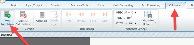

I just opened your first file (solarcollector) and noticed that automatic calculation is turned off.
Go to the "Calculation" ribbon" and click "Auto Calculation" and all should be OK again.
