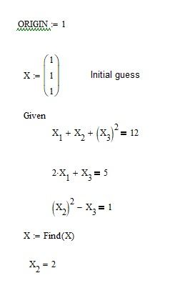

Do you mean you have 100 simultaneous algebraic equations in 100 unknowns and just want to find one of the 100 from a Given ... Find solve block.
If so, you can do this by representing your 100 X's as a vector.  You need to solve for all 100, but can simply extract the one you want, and you don't have to write a huge list of values inside the Find expression.
Here's an example with three Xs (because I'm not spending the time to do 100):
If this isn't what you mean, then you will need to explain your problem more clearly.
