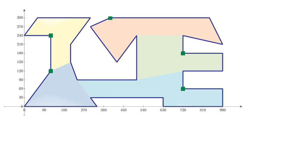

Here's my simple starter for the polygonal version only.
Alan

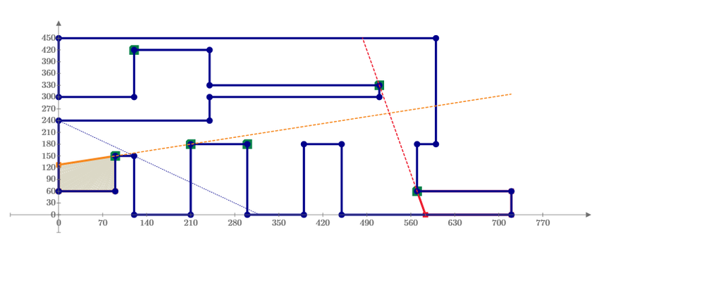

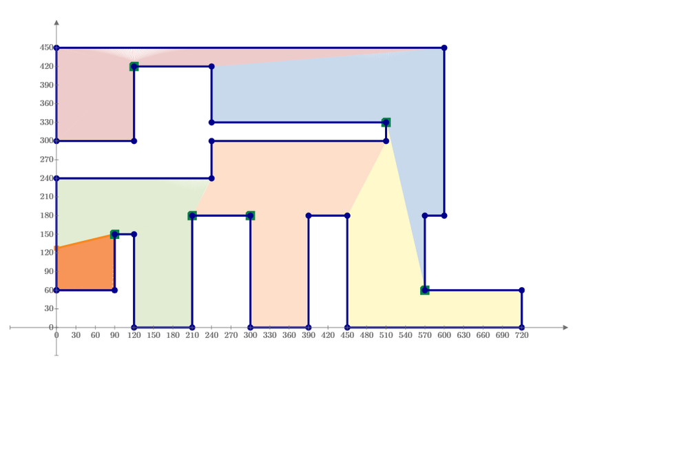

Here's a similar approach to the Orthogonal case:
As before, the positions of the guards is not unique, and I haven't indicated overlapping fields of vision.
In both cases I just used a visual approach, as I haven't figured out an algorithmic one.  I'd be interested to see if there is one.
It's not clear to me if the question is looking for a positioning with minimal overlapping fields of vision - if so, I haven't tried to find that!
I guess the last part (Challenge 5) will require the actual calculation of areas - something I've tried to avoid so far!
Alan

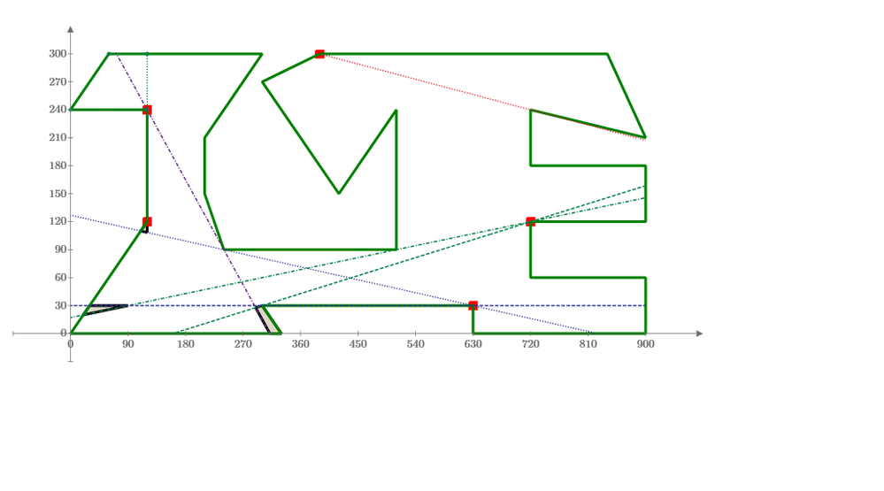

Using AlanStevens method, I make 5 guard positions answer.
The total area is 176400.
Change some positions and remove guard G26, the uncovered area is 3.06%.
But when remove guard G27, the uncovered area is only 0.45% by 4 guards.
Removinf G2, the blind area is 3.55% for 5 guards.
