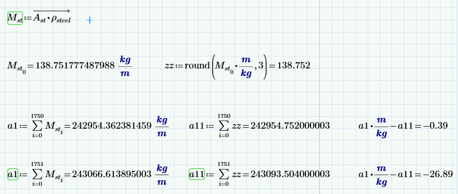

Hi All,
I created a set data and put them in matrix. Some data product has return the correct value, but there is not return the total sum of the array. Not sure why this has happen.
Please help.

Since your values in each vector are all the same, why are you carrying vectors?
8-Gravel
July 7, 2023
The vector calculate @ each 1m point of the line

I do not understand why the sum from 0 to 1751 produces different results. It seems to me that the problem is related to units...

If you tell Prime that it should multiply two vectors, you of course get the scalar product.
For what you seem to intend "vectorization"  as already shown by others is intended.
See the difference:
BTW, the unit for your Thermal Expansion Coefficient is wrong! It sure should not be 1/coulomb!
Use Delta°C or even better K (Kelvin)
