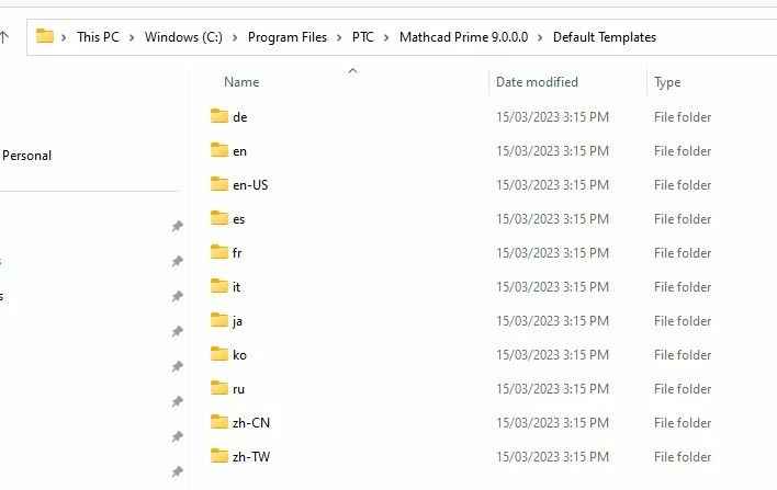

Best answer by terryhendicott
Once you have made this template change converter will bring in A4 as A4.
Some Background: Existing Templates are located at
The setting that chooses which directory to determine which Templates are in use is set using the Prime Circle | Options Menu | Options Tag
I set A4 and small margins for all my documents.  You just need to use a template file with these two set.
Take a new clean sheet.  Set the A4 and small margins.  You could also set anything else like headers etc.
Then save the template using the template file format
You need to save the file first before setting as alternate template in options of course.
Cheers

April 11, 2023
Cheers
Terry
