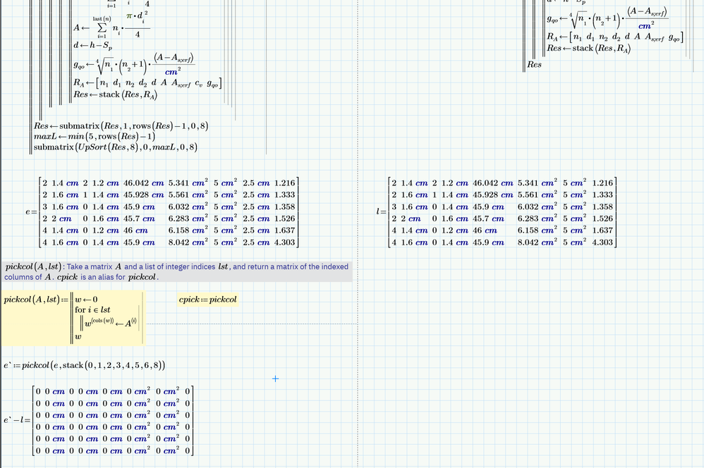

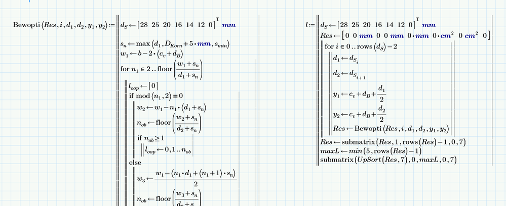

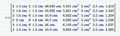

Hello everyone,
could someone explain why i am getting different answers in the programs e and l.
Is there a way to get same output from both the programs? Does it have something to do with for loops?
the output should be like program e.
Attached Mathcad 10 file.

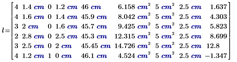

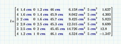

Best answer by StuartBruff
You need to include Res as an argument to Bewopti.
See attached MP10 worksheet.
Stuart

Just a note ... it is necessary to switch Page View to Draft View to see l definition on the right side.
ttokoro
November 14, 2024
If add Cv and change 7 to 8, then you can get same cols.
t.t.
November 14, 2024
Sorry, may be you did not understand my questions. I mean all the numbers should be same in both the programs.

November 14, 2024
Stuart
November 15, 2024
It worked. Thank you soo much.
