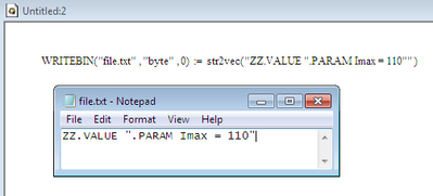

Further, how about:
LucMeekes23-Emerald IVAnswer
October 14, 2020
You should state the version and kind of 'mathcad' that you are using:
Mathcad 15, or Prime 1,2,3,4,5,6?
Further, how about:
October 15, 2020
thanks, it is working!

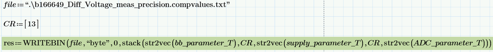

With several lines, on Mathcad Prime 6, I do the following:
