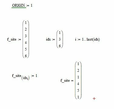

Hi, I´m translating some matlab code into a Mathcad, I need to overwrite indices in vectors
Matlab does it like this:
f_site 23x1 Vector
idx 13x1 Vector wich has the indices i need to overwrite.
f_site(idx)=...
In Mathcad I cant do it like this
Thank u
You could simply do it like this
using the same approach to identifying the appropriate values of theta12, cc etc.
Alan

Something like this?

Yes that could work but  I need to call out the indices of vector to overwrite them like this:
d74b5dc1-b277-4595-8899-70e8c4eb1805.jfif
Alan
