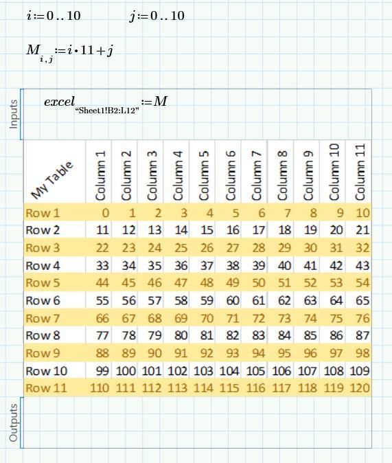

I want to get old looking matrix formatted into table with columns as it used to happen in Mathcad 15 I am unsure how to do that in Mathcad Prime

Prime does not support a different table display of a matrix.
But it displays large matrices scrollable and you can turn on/off showing the indices. Unfortunately the way to scroll is ridiculous childish and very uncomfortable.
It is possible using the Excel Component where the formatting is done in Excel for a much larger formatting set.
For example:
