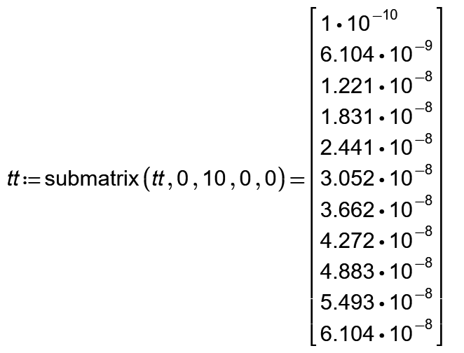

In my attached Mathcad 15 worksheet, I am trying to compute an IFFT of an analytic function of frequency for a know time function.  To display the desired bandwidth, I have to use a large number of points.  Time points = 2^m and frequency point = 2^(m-1) where m=24.  The final plot will not plot due to the maximum plot points unless the step size is at least 70.  The way I have reduced the plot points means there are only 2 points between the first time point and the next time point at step x Dt.  I tried to do an interpolation from the original vectors to fewer time points; it ran forever.  Maybe user error on the linterp function.  Attached is the xmcd file.  Auto calculation is turned off.  The calculation time on my old PC is about 15 seconds.
1.  Can linterp not interpolate to fewer points?
2.  Is there a better alternative to what I have done?
Thanks much.

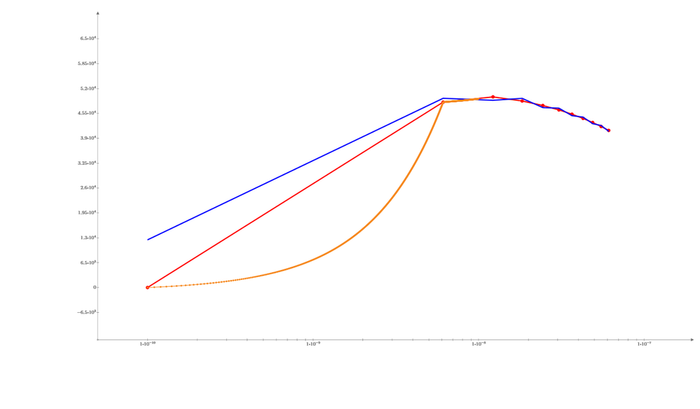

Best answer by ttokoro
1. Use small data set you want to linterp the function.
2. linterp the function.
3. Plot it. linterp points are linear lines but you polt it log-log scale, therefore, it looks curve line.
4. If you want log scale interpolation, check old posts that show how to do it.
