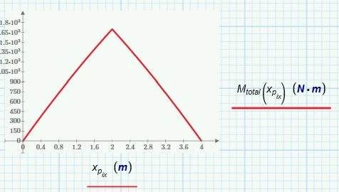

I am working on a simply supported beam calculator. I have everything up and working but I am having trouble when it comes to determining the maximum of the displacement and it's corresponding x value.
In the collapsible area under the loads you can see I have the various displacement equations and to find the total displacement I sum them up. I then need to find where this value is a maximum but I don't know how to do it other than reading it off the graph.
Is there a more elegant way to determine the maximum so I can define a function for maximum displacement and corresponding x-location. I have attached the sheet for reference.

Hi Callum,
There is a difference between a range variable and a vector.
Capture.JPG defines a range variable.  It does not create a vector.
I like to define a vector "x" and a matching indexed range variable "ix"
This following code creates a vector "xp" and a matching range variable "ix"
The subtle change is that you can create a vector of deflections at points on the beam and find a maximum of that vector
The solution comes  with a drawback in that you need to use the index variable "ix" in the plots
Cheers
Terry

Hi terry,
Thanks for you response! I have got it up and working now.
Best Regards,
Callum
