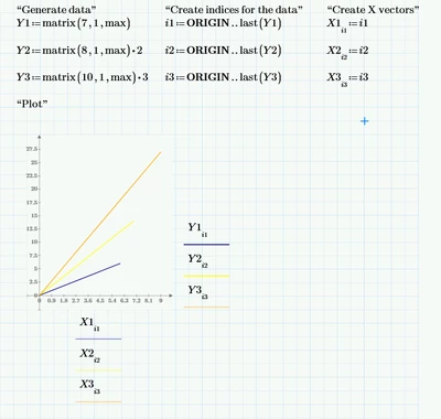

In Prime 3.1 it looks like this:
Prime 3.1 file attached.

Plot 1 has 7 data points. Plot 2 has 8 data points. Plot 3 has 10 data points. I want all three plots on one graph image. Prime 3.1 does not seem to recognize, nor allow me to specify what x-values go with a particular plot. Thus, plots 2 & 3 (or added traces) have their data at the nearest x-values for plot 1. Since one can tell x & y values in Excel, why can I not tell MathCad what x & y values I want to plot?
