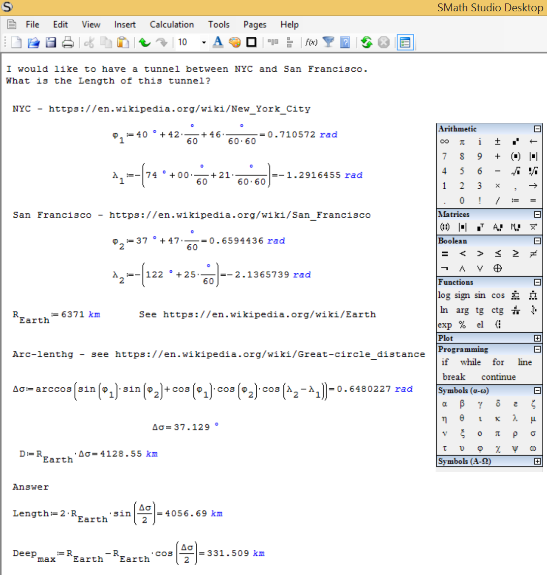

A train leaves New York at 9:45am EDT, heading for San Francisco...
The train system consists of a straight-line tunnel connecting the two cities. The train uses a MAGLEV (magnetic levitation) system consisting of permanent magnets in the tracks and superconductive electromagnets in the train. To accelerate it uses a combination of electromagnetic force and gravitational pull of the Earth. The deceleration comes also from the gravitational pull of the Earth, as well as aerodynamic drag of the train.
Problem: Compute the arrival time in San Francisco assuming constant propulsion force.
Video Link : 5750
Mathcad 15 file in attach
