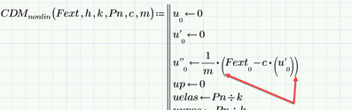

I  recently obtained a research script based on mathcad (old version) by my colleague and i tried to follow the sequence using Mathcad Prime v3.1. But it shows error after copying the whole sequence on Prime.
The aim is to produce several acceleration graph as seen in the file images.
The script image named after capture 1 to 4.
The error image i encountered was in Error 1.
Really appreciate if someone can rewrite it in Mathcad Prime version would be helpful for my research in earthquake seismic design.
Thank you.

There are two errors:
1) you have typed square brackets [ ] but you should only use normal parentheses ( ). Mathcad 15 and below will occasionally show nested parenthesis as mixed, square and round. But thats for display (and is not done in Prime). Always type ( ) in arithmetic expressions. Using [ ] in Prime means you are creating a matrix/vector.
You have used square brackets two times,
2) You got the structure for the assignment of a value to u_prev and u[i+1 completely wrong. This part of the routine is at the end of your capture1 and beginning of capture2 and should look like this:
This is what that part of the routine should look like in Prime
As an alternative you could also do it that way:
I have not attached the corrected sheet because I am using Prime 4 and ridiculously Prime cannot save in older formats and you would not be able to use a P4 file with your P31.
Hope its clear what you will have to do.

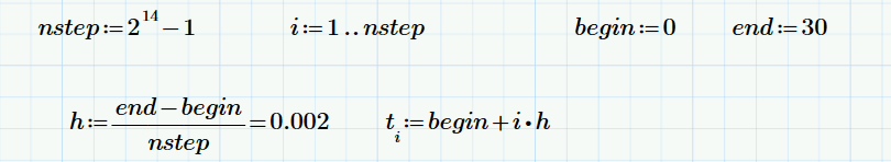

(To:Jeremy)
OK, as far as I see all your problems come from using literal indices where you should have used matrix indices.
A literal index is what you get when you press Ctrl and - or chose "subscript" from the menu. What you then type as subscript is simply part of the variable name.
What is needed in your sheet are matrix/vector subscripts as they determine which element of a vector is meant.
You get a matrix index by typing [ or you can chose it from the operators menu in the first ribbon.
The optical difference is not that big - vector indices are a bit lower in Prime and if you click in the region you see a small square (left: literal, right: vector):

Hi
I manage to change all the literal indices to matrix index. It shows positive sign but at the end when i tried to compute a function, there is a error.
Attach is prime script

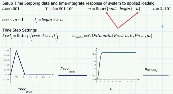

Hi Werner,
I encounter another error when trying to input another loading function as shown in image below.
Attach is the mathcad prime script.
-Jeremy
(To:Jeremy)
Again a problem with the square brackets - parameter parenthesis also must be "round".
What you had created was "floor times a vector".
BTW, you don't need to apply the vector indices in the plots - you could also simply plot one vector over the other.
You can move the axis labels to different positions and on each axis you can change the first, second and last value (its a bit tricky as the numbers are far too tiny and can't be scaled).

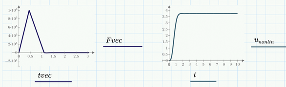

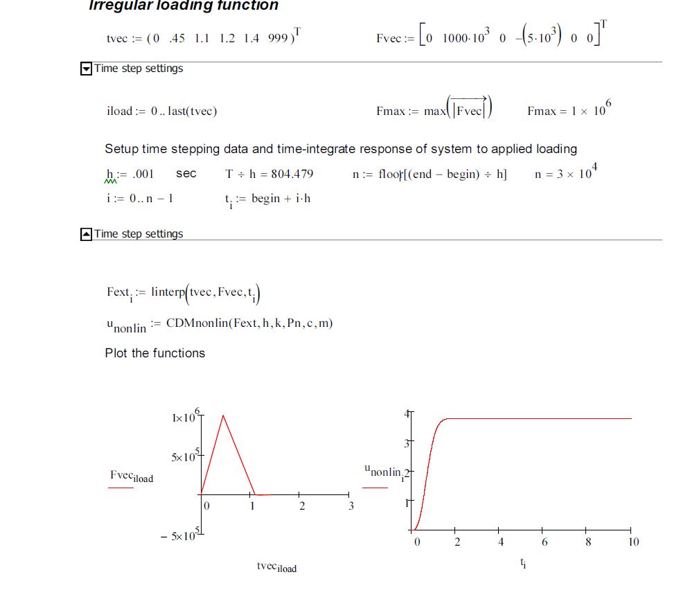

Hi Werner,
Sorry for keep asking question on the script as i am not used to mathcad, my sincerely apologize.

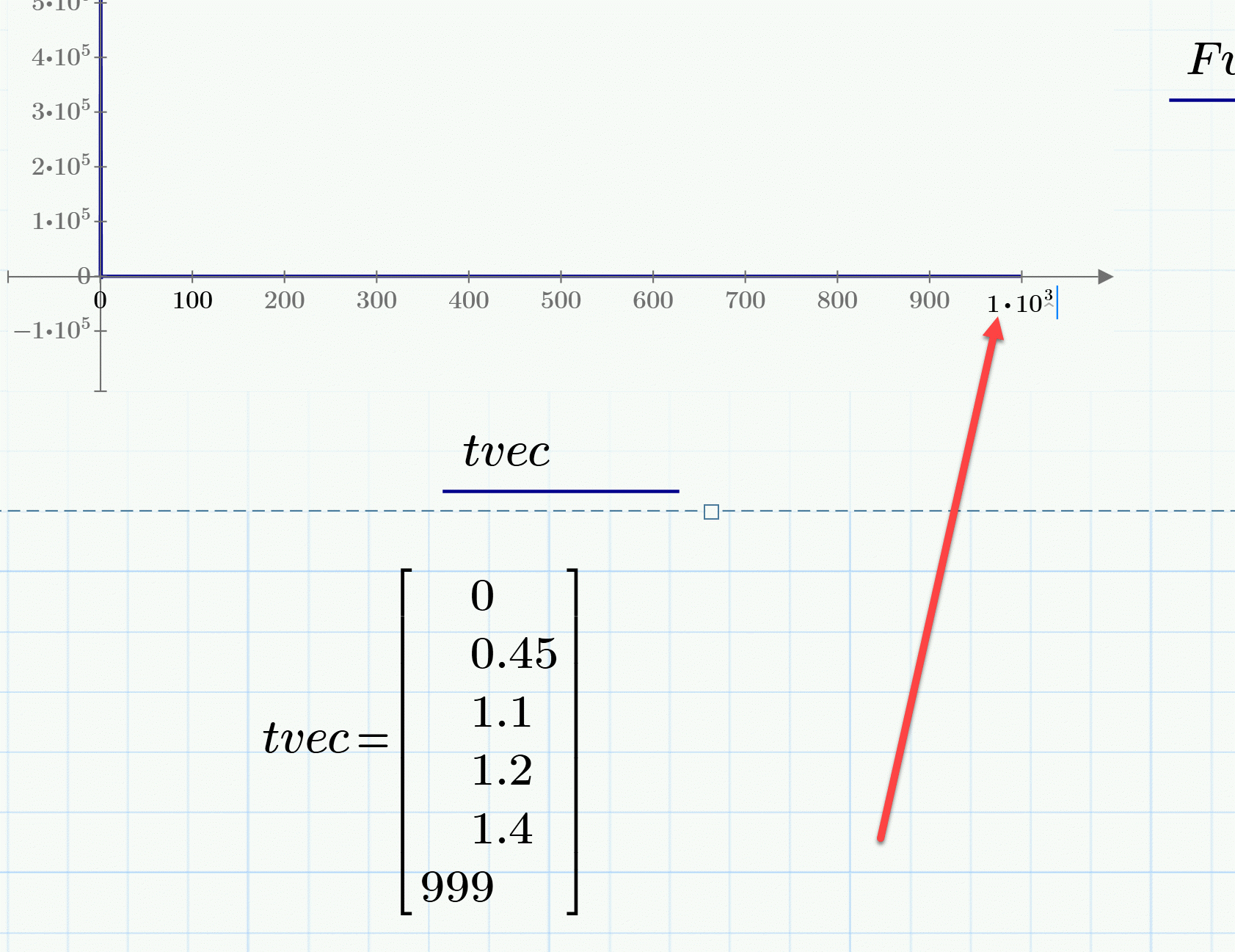

I have question regarding how to change the graph under time step settings in irregular loading function ? because i am getting a straight line on both axis.

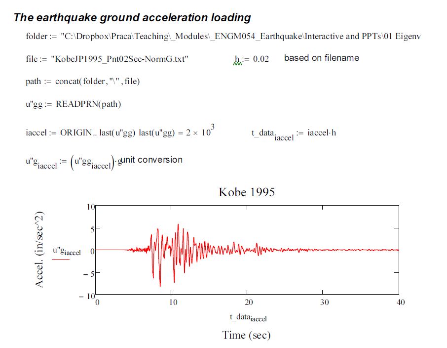

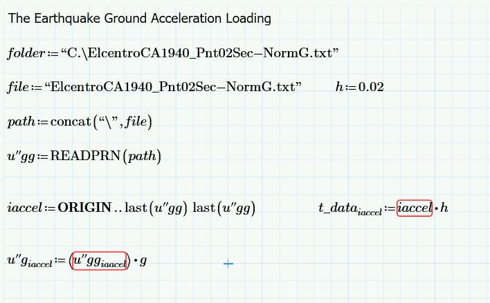

For the last part, the script required to create a path where a person can insert folder name, file, and path where the file is in .txt as attached in the rar (one of the earthquake acceleration occur in elcentro). I tried to execute the script and failed as the iaccel:= (non responding answer where there is a yellow circle keep moving as seen in the image
Attach is the prime script.
Thankyou
(To:Jeremy)
Look at the max value on the abscissa! Its 1000 because the last value in your vector tvec for some reason is 999 (not sure why). You can set that end value to any value. In the former file I had chosen 3 as in the original script.
It looks like the read-in in the data was done successfully. You have a typo in the folder name (C.\ instead of C:\" and you don't use the folder name when creating the full path to the data file. Not sure if this was done on purpose by you. For testing I changed the path to access the data file in the current dir.
One error was that you misinterpreted the end value of the range iaccell as being last(u''gg)*last(u''gg) while in fact its just last(u''gg). The other last(u''gg) is already another region and is simply evaluated there to see how many data points were in the file.
The second error was the use of a literal subscript which in fact should have been a vector subscript (three times, see picture).
You may notice that in my plot I have moved the abscissa axis down for better clarity and added a dummy zero-line (abscissa). Again you will have to set the first and last value on each axis manually to have better control over the outcome and also set the second value on each axis as Primes autoscaling usually is rather useless (seems to simply divide into 10 sections, whatever step that may mean).
