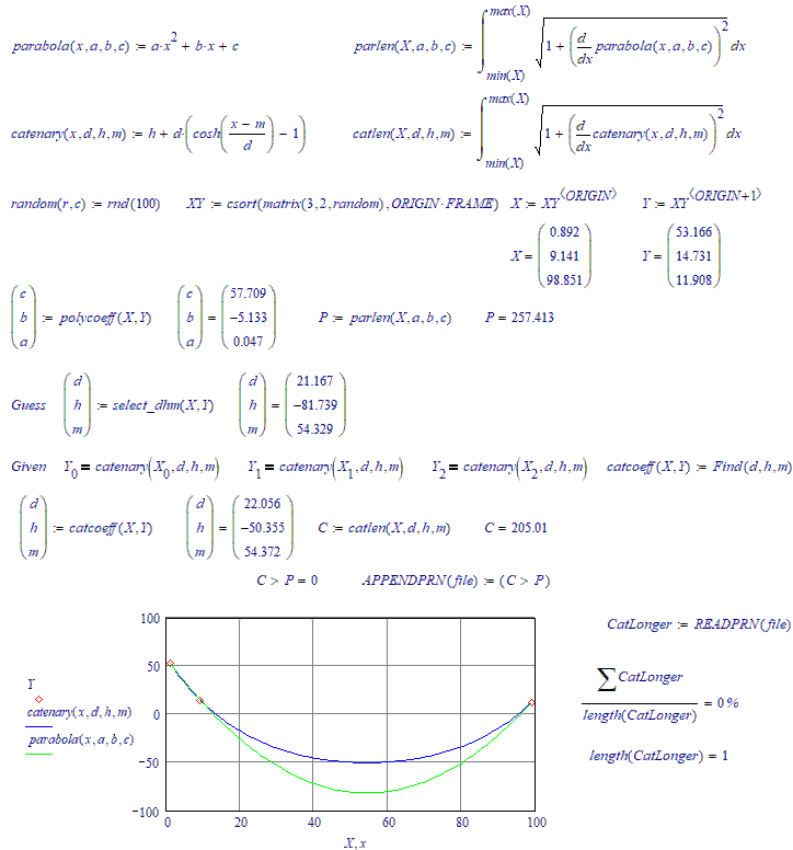

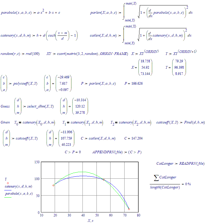

About 20...25 %.
First run over 100 iterationsFirst run over 100 iterations
No, it's more towards 30 %. The next run is over 200 iterations:
And finally over 1000 iterations, but showing only 1 in 5:

I've got a puzzle for you: try to find what my select_dhm() function is... (The function I use to provide guess values for the solve block of finding the parameters for the catenary function)
rnd, error and cycle?
No, it's not trial and error. I have an algorithm (a simple formula) that spits out a single set of guess values, with a success rate of over 99 % (that using those guess values, the solve block will find the catenary function parameters. If you look carefully at the animations, you can see the miss shots every now and then...).

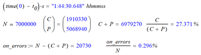

Rnd, on error and cycle (trial and error) - 99.999%
That's better than a Sputnik V vaccine...

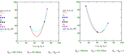

000100000100010000-0000011010000-00---110000100010000100-011001-0101101-01100000--1101--110101-010-010000101-001-010-0-0001-1-00000--0-10011101000-0-0-00-01010000-0-01-10-0001000-010100-0-00001101011100000110110111--0101-01-101010---000000001000100-000001100111000-10 (Tomorrow I will continue my research)
1 - Sc > Sp
0 - Sc < Sp
- (hiccup) - no solution
* - Sc = Sp (I am waiting for)
It's like a hiccup. You don't know when you will hiccup next time - when next time there will be no solution of the problem of catenaries and parabolas.
By the way, there is a very interesting study of the frequency and strength (- or ---) of hiccups.

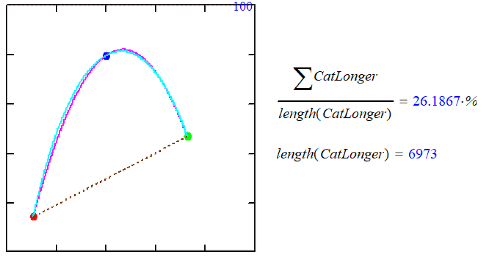

Catenary longer than a parabola about (a bit more) in 26 cases out of a hundred.
With prorgramming
