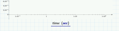

There is also very limited control over the Log plot scale, and sometimes, when playing with Minimum and Maximum under User-Defined Range, the scale displays something completely weird - as shown in attached screenshot. This is probably also a bug.

You're using the wrong plot tool, this is Prime 4 but the same is shown in Prime 6:
Note that the plot tool that was added in Prime 5 is a third-party component. It has other quirks besides not showing tick marks on log scales.

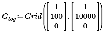

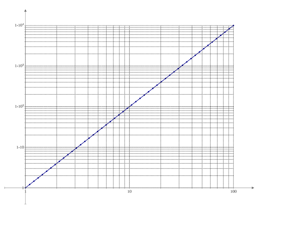

Unfortunately the native Prime plot is not able to add gridlines unless you create them on your own like shown here.

image.pngimage.png Using Grid function made by Loc and community members.
