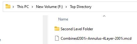

You must use the power of windows to select all the files in all the directory tree structure.
the converter will place the new files in the correct directories..

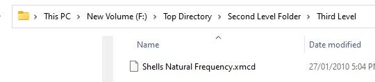

For example a three tiered directory structure.
With one Mathcad 15 etc file per directory.  This works no matter how many files in a directory
Note one file is *.mcd other two are *.xmcd.

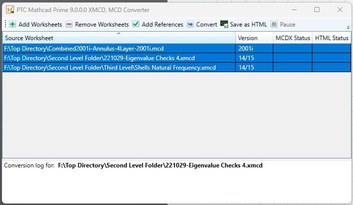

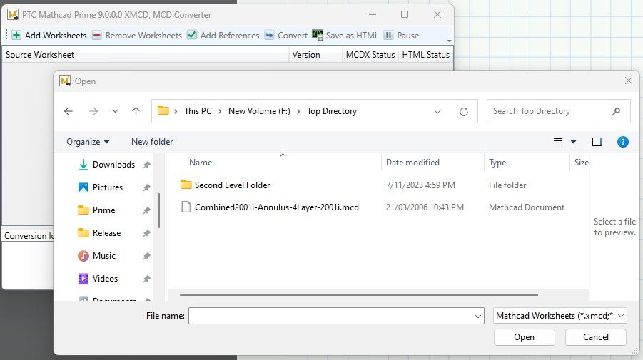

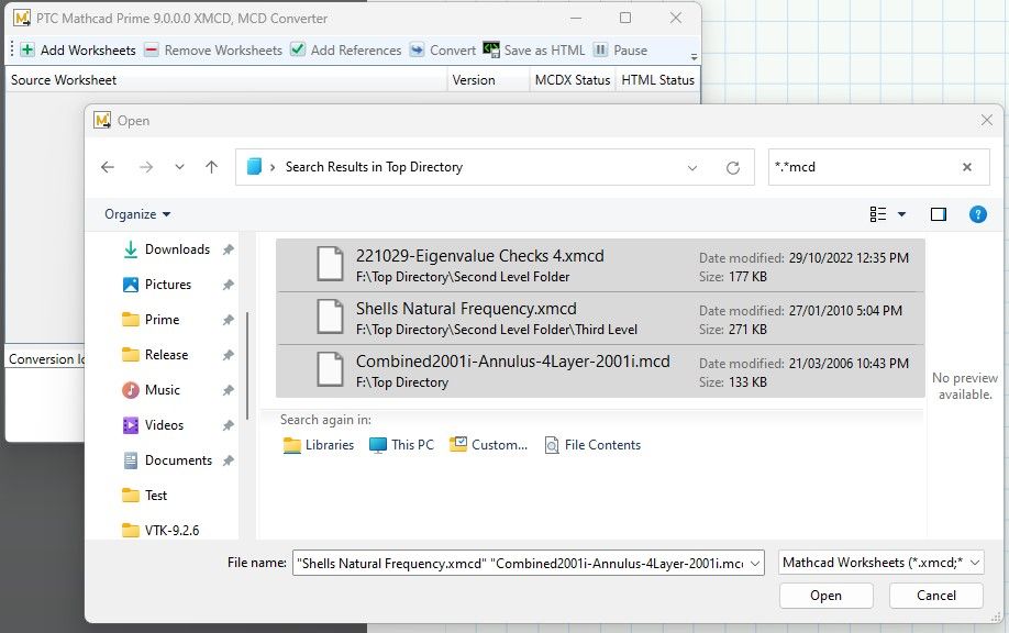

Start the converter from Prime or as stand alone and press add worksheets
You get the windows open dialog box.  In the upper right hand search box type *.*mcd as the search term and it will select files in the directory structure for you.  Ctrl A will select them all.
Choose open and the list box in the converter is filled with the relevant files with their directory included.
Select  them all with CTRL A.  Press convert and leave it alone until finished.

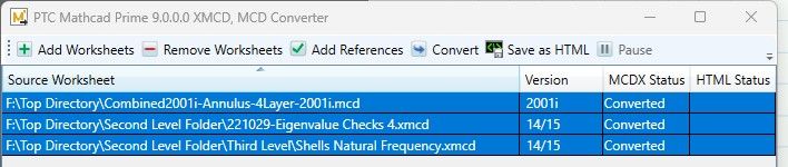

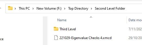

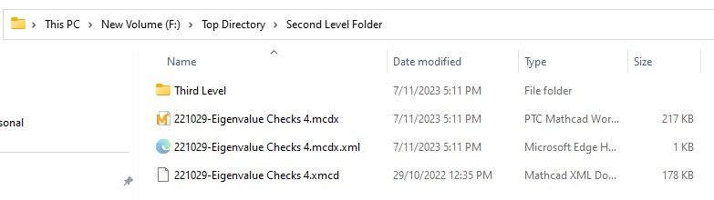

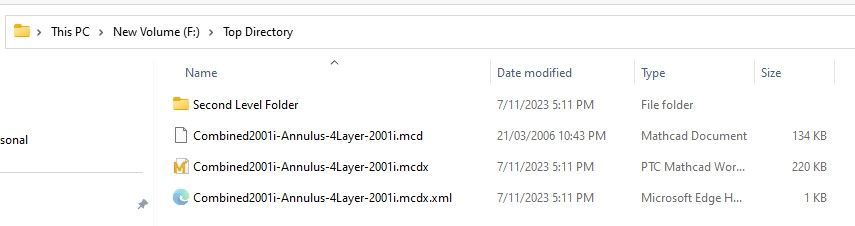

Now check the directories:  Each directory has the converted file and a html log of the conversion..
As far as I am aware there is no limit to the number of files in the directory tree.

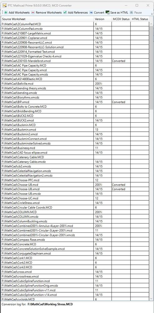

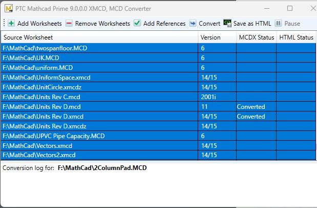

Converter can take large number files.  There are 233 files here loaded in one go from a directory
Press Ctrl  A to select all the files then you can convert them in one go:
