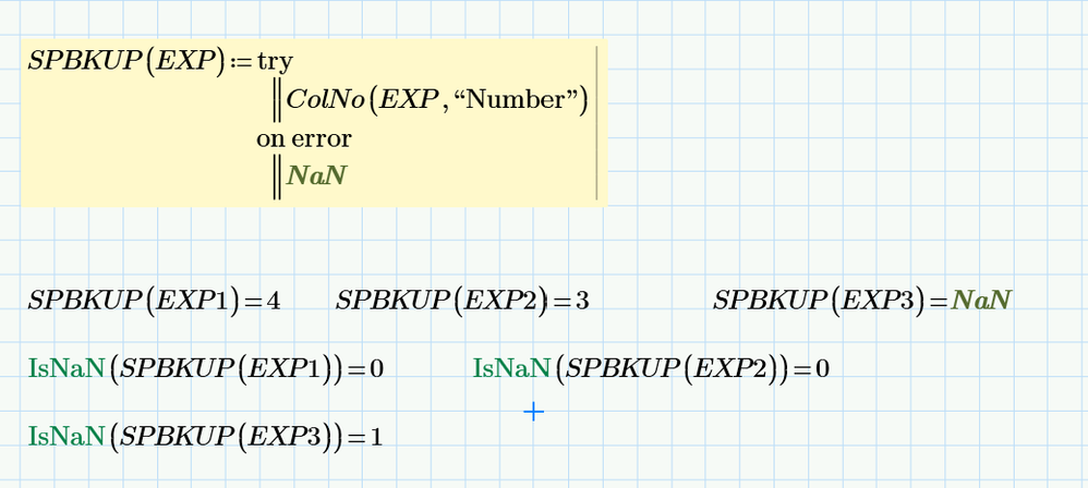

You may use "try... on error ..." in your function SPBKUP to catch the error and return an appropriate result like NaN or a text message.

December 14, 2024
So I wonder why you did not try the function I posted?
It works as expected:
