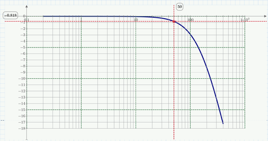

July 21, 2020
Hi Luc,
With your helps, I was able to plot the RC circuit in frequency domain. The problem is I would like to have the minor and major X-axis in log scale. How do you do that?
I searched in this Forum and found a solution Grids_for_Prime.mcdx, unfortunately it is a mess and I do not have a clue what is going on. Is there a better solution to plot log scale on the X-axis? Y axis is linear so I do not have problems with it.
Also from Grids_for_Prime.mcdx:
why we have this: G <--- [Nan Nan]
if axis = "y" and the following 2 lines (augment), can you explain what that means?
Dat N

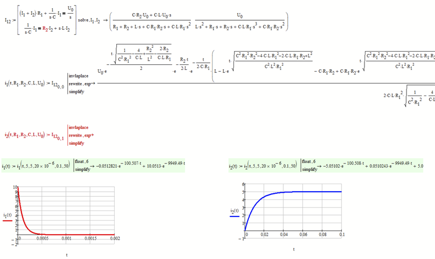

August 23, 2020
Marin,
I know you have an RLC file on the PTC.
I have a circuit problem I have gone over for a week. Could not get the answer.
I forced the process to make the answer work but that is make fit and I know its wrong.
I started on it with the differential equation mesh (loop equation) method.
I did not get matching answers. Then moved to the simpler initial condition method this was where I got closer. Case the answer maybe wrong, not likely.
Basically its the time constants here in the circuit there are two.
If you go by the usual RC  and RL time constants usually the simple case is either one or the other is used, here its both. Circuit reduction helps but this circuit's situation is the current in each branch.
If you got can do it easily or are interested to solve it.
I like to see the solution.
Karl.

August 23, 2020
Good.
Was that on solving a differential equation?
Do you have the steps you could send me?
