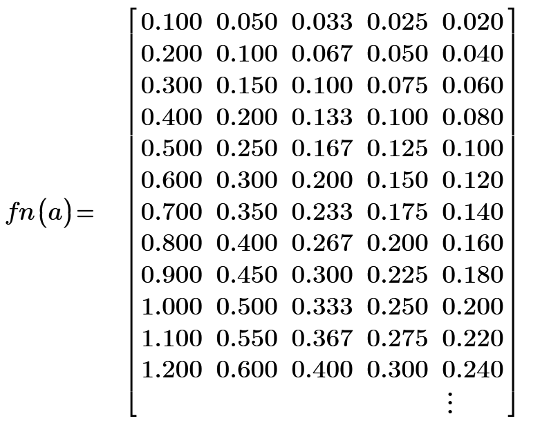

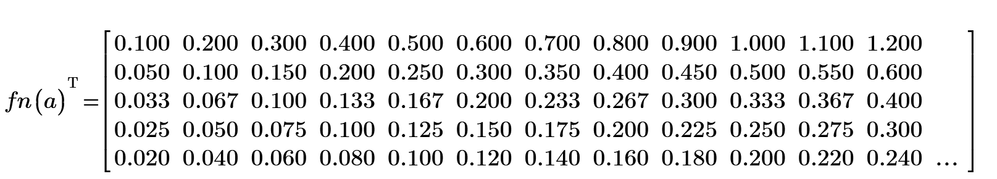

What does rows and cols? See below the example at which I am referring:
And beside the fact that:
ttokoro
(To:Cornel)
5 REPLIES 5

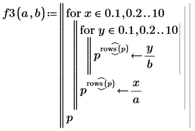

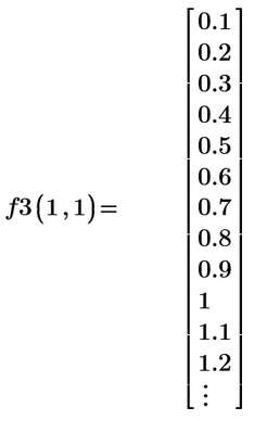

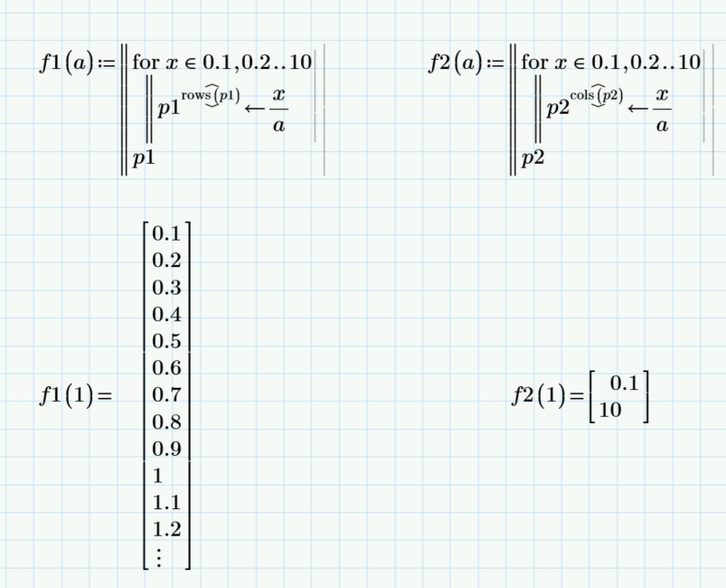

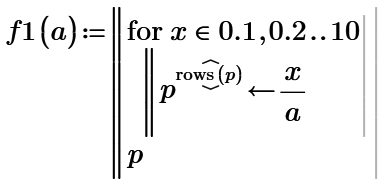

How to make like below?

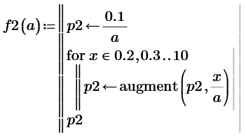

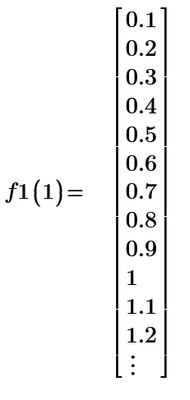

For the first, I tried as below but did not worked:
Result:

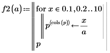

observe matrix M:
Prime has a rows selector, [Ctrl-Shft-R], and to select the first row:
And a column selector [Ctrl-Shft-C], and to select the first column:
Note how the angle brackets around the 0 differ.
Now compare  that to your two programs for f1 and f2.
Cornel
(To:LucMeekes)
Oh, Ok Luc, Indeed works better now:
