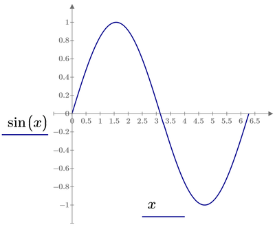

It is a sinusoid:
Is it a sinusoid or this curve has any other name?

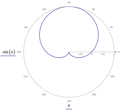

Its a Cardioide! Try sin(x)-1 instead of sin(x) and use a regular polar plot (with zero in the centre).

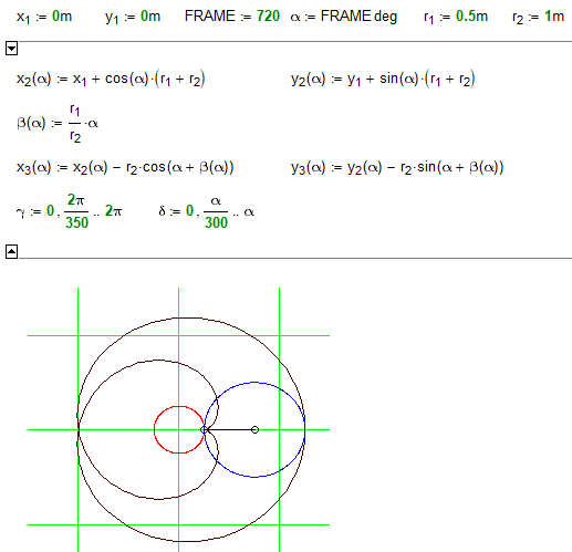

My method to animate the cardiod
What your pic shows is an Epicycloid (or Hypercycloid).
Most of them don't have special names.
Only if r1=r2 its called a Cardioid and if r1=2*r2 its called a Nephroid.
If a circle rolls INSIDE another, the path is called a Hypocycloid.
And if you watch for the path of a point not on the perimeter of the circle, its called a trochoide.
