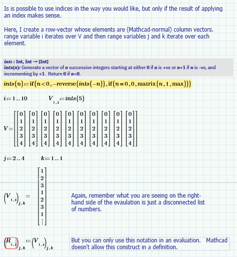

First, and very significant, point.   What you are calling a "subscript" is actually an "index" - a subscript is a very different beast and is part of a name.
Second, and also very significant, point.   When Mathcad sees a range variable on the left-hand side of an equation, it iterates over it.   Unfortunately, when you evaluate an expression, the result looks like a vector but is actually just a collection of individual results that do not form part of a data structure.   This catches a lot of people out - Mathcad could do with a separate way of denoting a range variable evaluation so that the distinction is clear.
What are you trying to achieve as an outcome?  Would the submatrix function better meet your needs?
Stuart
Oh, forgot to add, it is possible to use this notation in an evaluation (=) if the elements of an array are themselves arrays.
The error message for the last definition is along the lines of "a function or variable name is required here".

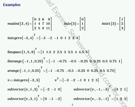

Hello Stuart,
I am new to this software and learning over the days. Will you be able to attach the worksheet for my better understanding?
Thank you,
James
@JH_9781973 wrote:
Hello Stuart,
Thank you,
James
Sure.   My apologies, I thought I had - it was in my Mathcad folder.  I've added a few functions that I find generally useful for creating vectors and matrices covering ranges of numbers.
