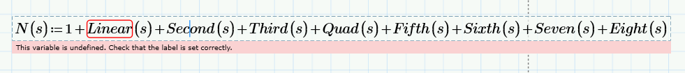

I have Linear(s), Second(s), ..., Eight(s) defined but when I tried to evaluate its coefficients and sum them, I am seeing this error:
Any idea why it is giving this error?

That IS the right way to assign a value to a constant.
Now the question is whether it is defined in the right place....
Mathcad reads a sheet file left to right, top to bottom. Any variable you use MUST be numerically defined before it is used, otherwise the numeric processor complains (what it does now for your definition of N(s). Only the symbolic processor can handle symbols without a value assigned to them.
You define, through a symbolic definition Linear(s) to be some expression. In that expression c1, c2 and a lot more are used. At THAT moment these c1, c2 are NOT defined. And there is NO indication in the parameter list of Linear() that they should be supplied later. SO...they MUST be defined at that moment; or else, you can only do symbolic calculations with Linear().
The neat and clear way is to supply all (necessary) parameters with each of the functions Linear() Second() etc. See my post from this morning, below.
It might just work without that, if you only define N(s)  as
N(s, c1, c2,....) := 1 + Linear(s) + Second(s) +... ->
(so by adding a symbolic evaluation parameter in the end.)

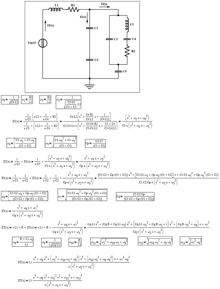

You should define all the constants (see example in the photo). Impedances are functions of the complex variable s. If the functions have no argument, the s is considered by the system as the unit of measurement of time and colored blue.

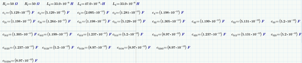

Thanks but I though I already defined them. Please see my original attachment. Here is part of it:R_L_C_values.PNG
That is the correct way to assign a value to a constant right?

I downloaded the file again, just now, but the constant definitions are missing. However, you should use the micro-nano and picoFarad submultiples, micro-nanohenry, and also MHz or GHz which I think are implemented in Prime. You should also define units of measurement such as rad / s, krad / s, Mrad / s, and Grad / s.
To speed up the calculations it is not advisable to use expressions containing constants in the formulas but it is advisable to replace them with constants defined separately (for example the simple product RC should be replaced with tau, indeed the reciprocal 1 / tau can be set equal to omega ). the important thing is that the units of measurement are correct (for example in the expression s ^ 2 + sR / L + 1 / LC) it is advisable to define the constants separately: omega1 = R / L (which are radians per second), omega2 = 1 / sqrt (LC) (rad / s) for which
s ^ 2 + sR / L + 1 / LC = s ^ 2 + s * omega1 + omega2 ^ 2). For example as in the network illustrated here:

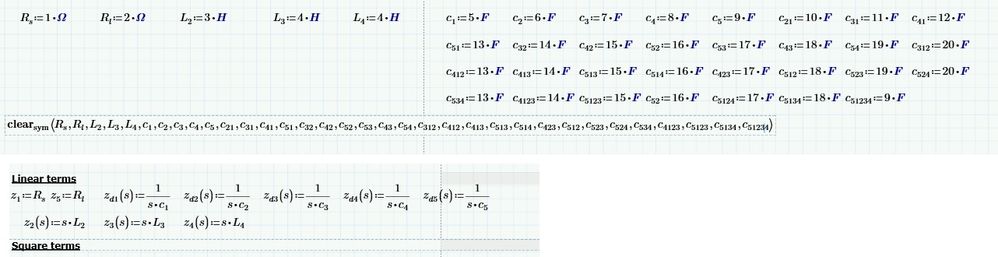

I recommend this approach.
You can build up your Linear Second atc. expressions symbolically or numerically whatever you like.
Make sure that you use a vector for each type of component, you could even put all components in a single matrix, but that would make the expressions less understandable.
You can fill the component vectors with numerical values like I did, or define them in terms of the actual component numbers like this:
etcetera.
