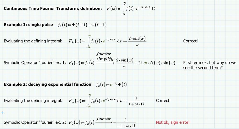

Hi!
I get unexpected results when using the Fourier Transform on some common engineering functions:Fouriererror.JPG
Am I not using the fourier operator correctly?
Please help 🙂

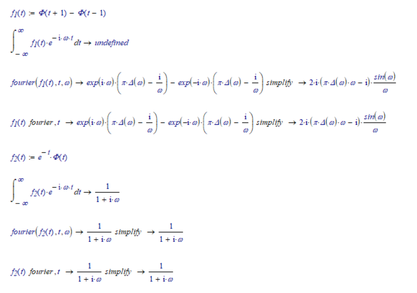

This may be a well known bug, due to Mupad (the symbolic processor).
This is what Mathcad 11 (Maple) gives:
