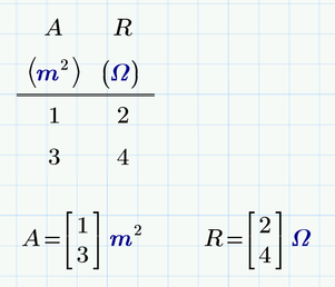

How can I copy paste the table from one to another in Prime with unit?
January 19, 2023
You can copy the whole table simply via copy and paste (Ctrl-C, Ctrl-V).
But you can't copy selected columns. Even if you highlight one column only, the whole table is copied.
But basically a table is just defining a couple of vectors. You can display those vectors one by one and of course you can also copy those vectors.
But you can't insert them in a new table because a table is just meant for manually inputting data.
