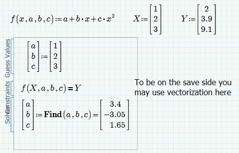

1) Why do you forumulate your solveblock so complicated? You may use the full vectors instead:

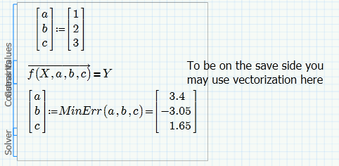

2) If your goal is a fit, a regression, you would rather use MinErr instead of Find:

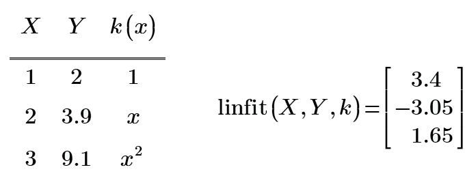

3) What you have done with the solve block can be done more efficiently using polyfit(s) or regress
4) In case one day you dont are after a polynomial fit, you would rather user genfit:

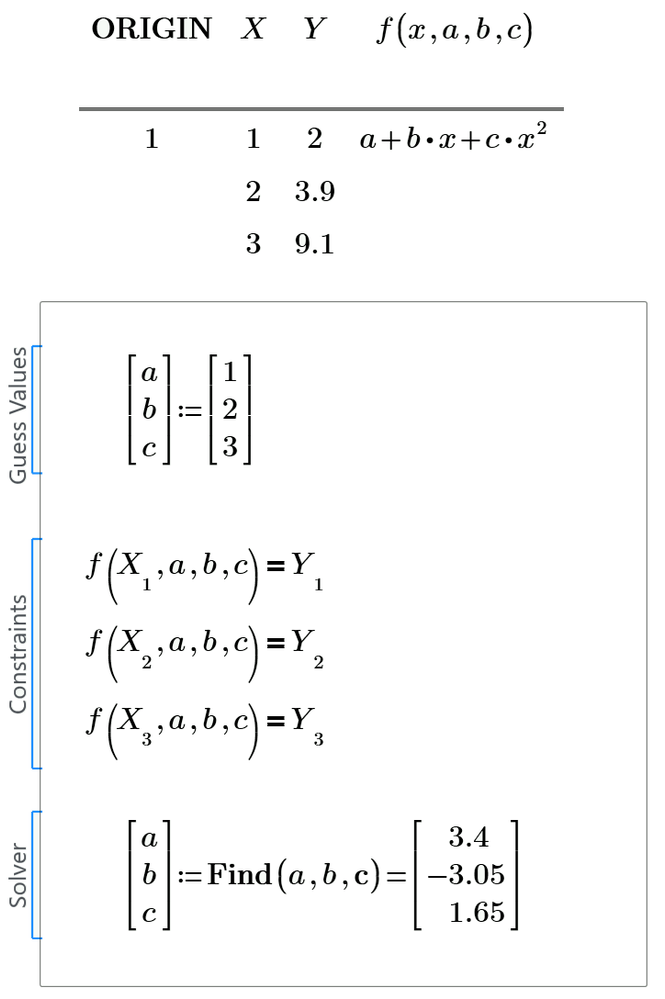

I think it is a shorter variant

Or, if you're stuck with Express you can do as attached
