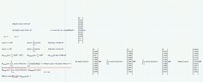

Hello, I'm still new to mathcad and I'm trying to understand why this error occurs. Because my z is defined but don't seems to work in my integer. Could somebody explain it to me ?

1) The error you experience stems from the fact that you are defining a function f.coring and try to numerically evaluate it in the same region (the "=" at the end).
You cannot numerically evaluate the definition of a function. The same goes for your definition of function RR.
Here a simple example:
2) You defined z as being a range. The inline evaluation in the definition (the "=" at the end which displays the range) has no effect. In versions of Prime prior to 10 doing an inline evaluation turned the range into a vector of values. This is not the case in Prime 10 and above.
So R.coring(z)=... or even RR(z)=... may show numeric results, what you see is actually an invalid data type - its not a range and not a vector either. You cannot assign these 'results' to a variable like Rmin:=RR(z) and you cannot access individual values (because you have not created a vector).
Solution is to create z as a vector or turn the range z into a vector and then call your functions vectorized. That way the results are vectors, too, and can be handled as such.

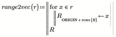

Here is a simple function which turns a range into a vector
Use it like z:=range2vec(z).
Its only starting with Prime 11 that Prime offers a function "vec" which does this job and also can be used to create a vector right away without having to create a range.
