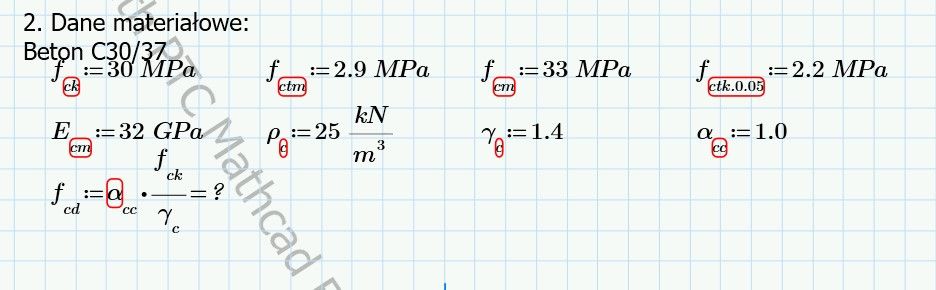

Hey why do I get an error when I want to define values?
I'm just learning the program 😞

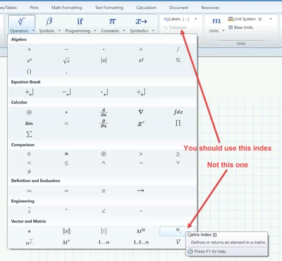

My guess is that you used the vector/matrix index instead of the literal/subscript index.
Use the index you get by pressing "Ctrl -"

Could you share your whole worksheet file?
