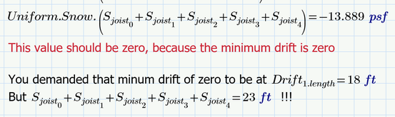

Hello All,

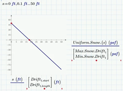

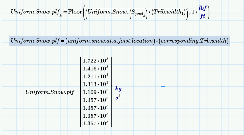

I have attached a Prime 9 sheet. I am trying to calculate  the uniform load on several members resulting from triangular snow load. i have included my instructions as to what needs to be accomplished.
Thank you for your assistance!
Sam
(To:SFares)
I don't understand why you think that that last value should be zero
With your function you simply connected two points by a straight line which also extends beyond the points

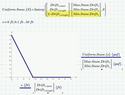

If your intention was that the function value should be zero for all values of s beyond 18 ft, you simply would have to add a third value larger than the last and with the very same function value.
Now you get

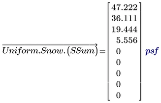

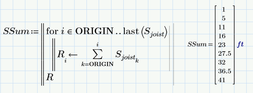

To automate what you did manually step by step you could create a vector containing the sum of all S-values up to
and use this vector of sums as function argument (vectorization not mandatory here but its good to be on the safe side)

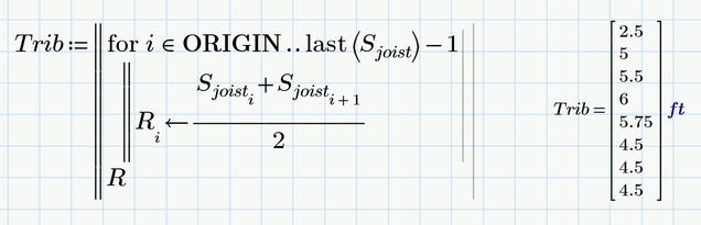

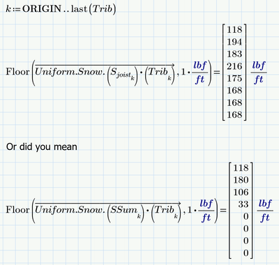

To automate the 'Trib' values you could use

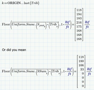

But for obvious reasons (every element is the arithmetic mean of the corresponding S-value and its successor but the last value in the S vecor has no successor)  this vector has one element less than the rest and so you would not be able to multiply the 9-element vector with the 8-element vector Trib.
But you sure can multiply the first 8 values
Not sure if that's what you had in mind
maybe you wanted SSum to be used when calculating the Trib vector and not S.joist? You have to know what you need
Anyway, P9 sheet attached

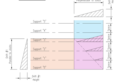

What  I have is snow drift, which is a triangular load. I was focusing first on Drift #1. As shown below, the snow is maximum at support zero then it decreases to zero. So support 4 and 5 get no snow drift, and that's why i said , the snow drift is zero beyond the snow drift length.
you stated "S-value and its successor but the last value in the S vector has no successor)  this vector has one element less than the rest", I agree with your observation.  believe i need to make and adjustment as to what happen ends at a support or somewhere in between. the load calculation will be different. i will have a follow up question later.

So your drift is triangular in two dimensions?
And the section of the drift at each joint changes?

Yes, its a corner drift. Depending on the magnitudes of the intersection drifts, the supporting member might have a uniform snow load from drift#1 and an additional triangular drift from drift#2. What i sent earlier and Werner helped me with, will work well if the spacing among the members is uniform. I modified the sheet ,and using  Werner provided, but i still have few minor issues. i will attach the sheet now and i have some questions inside the sheet-P9 in red text. I can also post the question as  a new topic.
