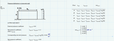

Want to show the values of the formula in a table.
MH_10592278
2-Explorer

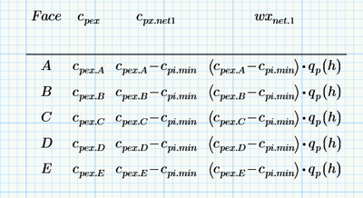

As shown above I have created an table with formula but I want to show the values rather than just formula. please help.
Thank you in advance.

Using a table you have created a couple of vectors (in a very inefficient and elaborate way (like in a spreadsheet calc program like Excel)!
You can always evaluate each vector numerically which will show the values.
If you really want create a matrix you can use the augment() function.
If you need further help with this you'll have to attach the Prime sheet.
